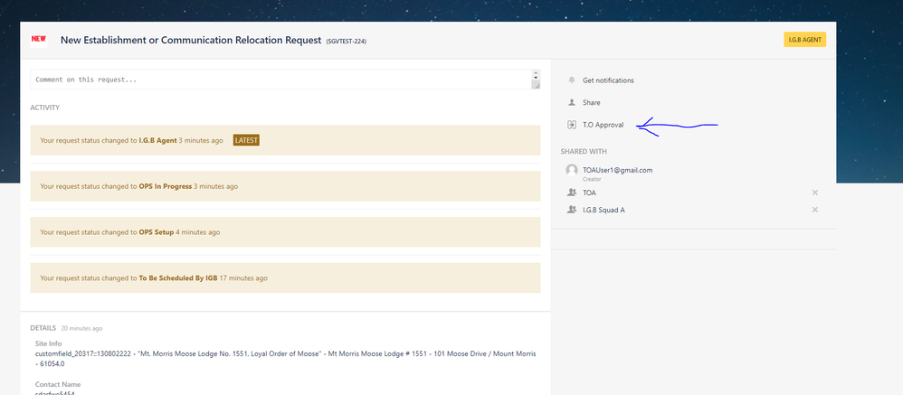

We work in groups. So when some one from a organization creates a ticket, the request will be shared with users in that organization. In some statuses, we allow external customers to execute the transition. So, when the customer is executing the transition, Organization field is getting cleared automatically and ticket goes away from the portals of customers where the ticket is shared with.

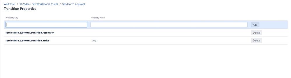

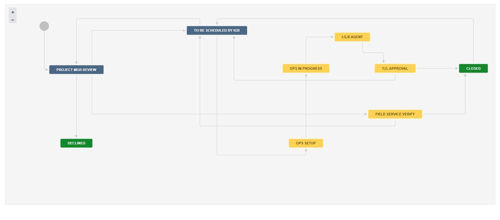

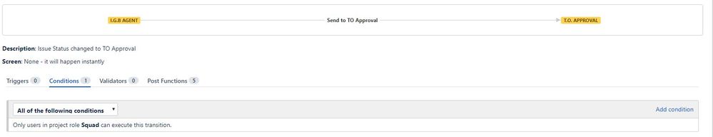

@Jack Brickey @Ivan Tovbin Thank you. There is no automation. There is no post functions except the basic one. I attached my workflow and Images. Transition from IGB agent to TO approval is customer facing. When customer clicks the transition, the shared with Organization fields are getting wiped off and the request is going away from participants screen.
