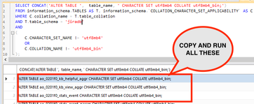

hi, thanks for the reply, do you mean below queries?
i did the below queries , still getting the same out put ...
SELECT CONCAT('ALTER TABLE ',  table_name, ' CHARACTER SET utf8mb4 COLLATE utf8mb4_bin;')
FROM information_schema.TABLES AS T, information_schema.`COLLATION_CHARACTER_SET_APPLICABILITY` AS C
WHERE C.collation_name = T.table_collation
AND T.table_schema = 'yourDB'
AND
    C.CHARACTER_SET_NAME != 'utf8mb4'
    OR
    C.COLLATION_NAME != 'utf8mb4_bin'

When you run this query you will get bunch of queries as output, and later you need to run these queries to get desired output.

You need to run queries that you are getting in output of above query.
'ALTER TABLE ... CHARACTER SET utfmb4 COLLATE utfmb4_bin'

@CasperHere are steps that I followed
  • Shutdown Jira
  • Backup database
  • Alter database collation,
    • Run query 'ALTER DATABASE jiradb CHARACTER SET utf8mb4 COLLATE utf8mb4_bin'
  • Alter table collation,
    • Run query
    • SELECT CONCAT('ALTER TABLE ',  table_name, ' CHARACTER SET utf8mb4 COLLATE utf8mb4_bin;')
      AND
          OR
    • This will return list of alter statement in output console, copy these and run again
