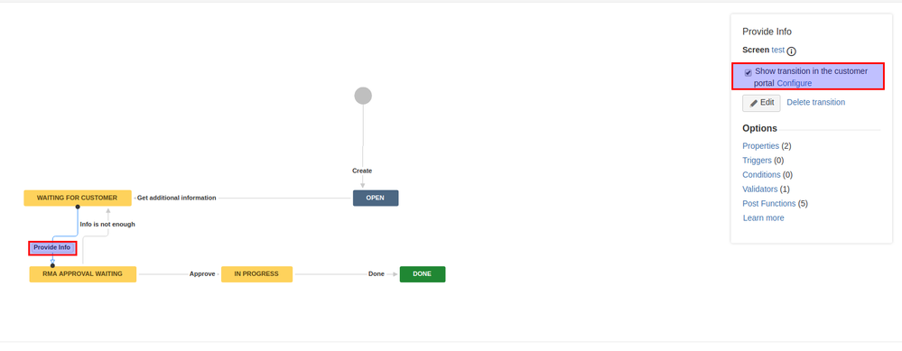

If I understand correctly, your customers open a ticket on your service desk and before RMA approval, you want to get additional information from customer. Is that correct? If you want to get additional info after RMA approval, you can adjust the position of status and that should work.
You can create a workflow similar to the one below. You can use a transition to get additional info from your customers. Your customers can get an email about this request via customer notification schemes of your project.  You can make "provide info" transition visible on customer portal and your customer can use it.
If that info is not enough you can send it again to the customer with "Info is not enough" transition. After that you can start your progress. Does it make sense? As I understand from your request, such workflow would do what you want.
