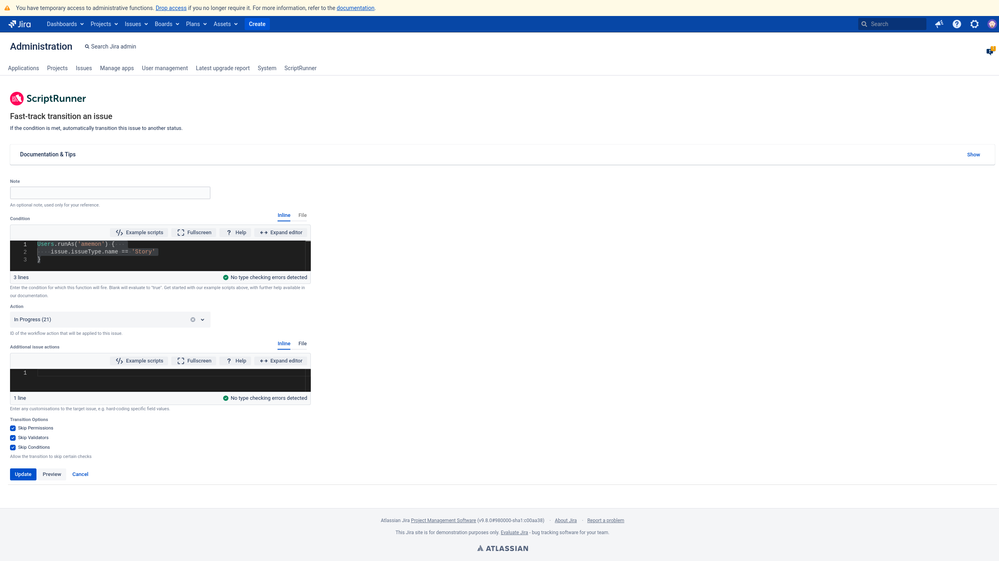

If you intend for the Fast Track transition to execute as a different user, you can use this approach with ScriptRunner's HAPI, i.e.,-
Users.runAs('username') {
issue.issueType.name == 'Story'
You will need to add this condition to the Conditions field as shown in the screenshot below:-
For more information, you can refer to this ScriptRunner HAPI documentation.

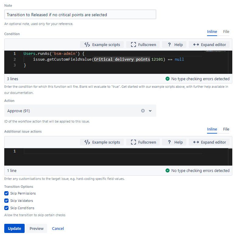

Jeanette Seewald March 27, 2024
Hi @Ram Kumar Aravindakshan _Adaptavist_ ,
I am having the same request (to have the "fast forwad transition" beeing run as a user that we use for automation processes), but your solution unfortunately doesn't seem to work in my case. The transition is executed, but with the current user instead of the "runas-user".
Do you have an idea, what could be the issue here?
We are currently on scriptrunner v8.20.0 and jira v.4.9.18.
I use following condition in the fast forwar transition postfunction:
Users.runAs('bsm-admin') {
    issue.getCustomFieldValue(12101) == null
Thank you a lot in advance,
Jeanette

Jeanette Seewald May 27, 2024
thank you for the response.
Yes, I want to check, if the customfield, which is a multi selection field type, has no checked values and if so, the issue should be transitioned to another status. The transitioning should be run as the admin user.
As the gestCustomfieldValue.toString() returns "null" the length returns 4, I changed it to
   issue.getCustomFieldValue(12101).toString() == 'null'
But I still get the same result: the issue is transitioned, but with my user account instead of the defined admin account.
The code needs to be in the "Condition" part and not in the "Additional issue actions" part, doesn't it?
Thank you and best regards,
Jeanette
