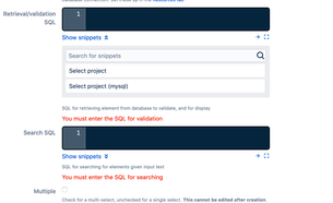

We have implemented our 'getSearchSql' and related functions in the Configuration Script as recommended in the documentation. HOWEVER, when I try to preview our custom functions, I get the following:
Now, we have DELIBERATELY left these blank because we override them in the Configuration Script field. The form doesn't care.

Update: here's an example of my problem: I want to run a query using the database picker that SHOULD NOT use the user input to show options (this may seem silly here but the actual use case is more customized than that). It appears with the current plugin that I can't do this without some dummy SQL that is definitely getting run even though the override is ALSO getting run and is what controls the results. Basicially, SQL is getting run twice and should not be.
The screenshot below shows what happens.
