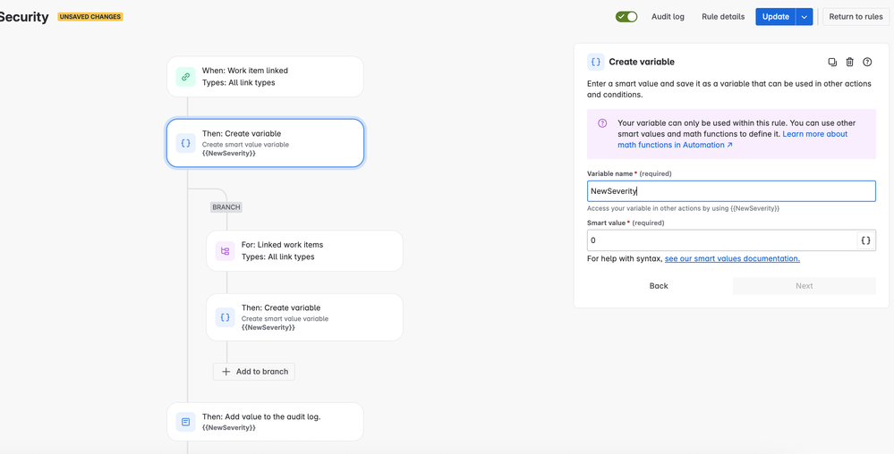

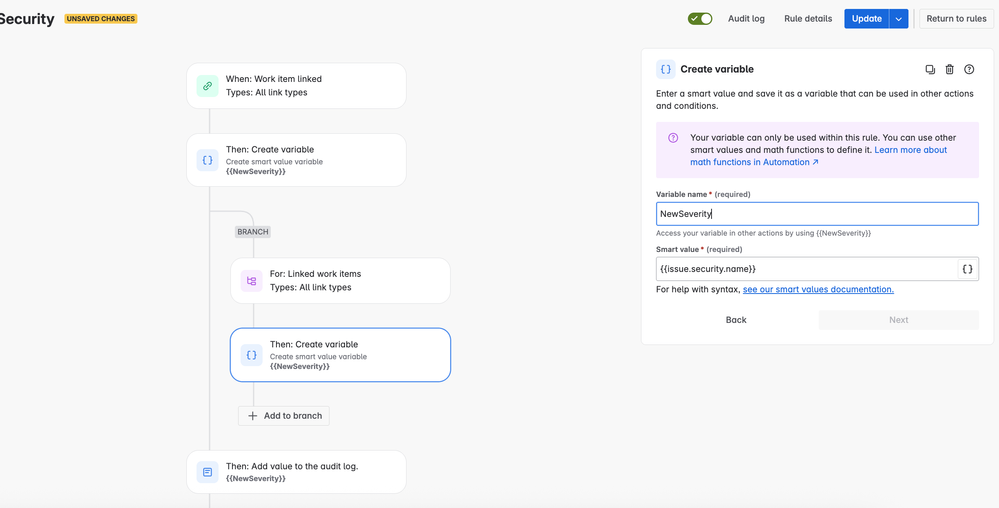

arielei
June 8, 2025
Screenshot 2025-06-08 at 19.21.19.pngScreenshot 2025-06-08 at 19.21.30.pngScreenshot 2025-06-08 at 19.21.39.png
