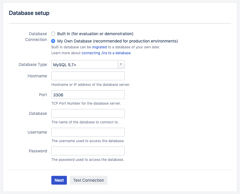

Since utf8mb4 is officially supported from JIRA 8.x and MySQL version 5.7
When the user selects Database Type MySQL 5.7+ in the setup wizard, dbconfig.xml automatically set database type to mysql57.
This dbconfig.xml configuration let Jira expect to use utf8mb4 Collation and Character.
<database-type>mysql57</database-type>
