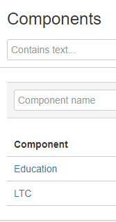

Az July 3, 2018
@Josh Loe
I have components set there and I have components in the project
