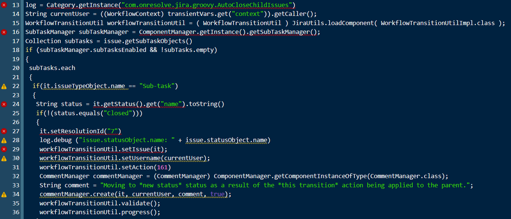

If I copy/paste th code in my JIRA I got a lot of unknown method error as you can see in the screenshot
I also copy/paste all the needed imports.
Do you have any idea why not working in my context?
Sorry, I'm a real beginner...

I still have the same issues, when I copy paste the code you linked to me I got a lot of unexpected error.

When paste into JIRA I got a lot of "Cannot find matching method"
You can't use the exact same code, as the code is a reference which is using the "transition" id of close for sub-tasks but in your case you have to move the sub-task from waiting to "To do" thus you have to use the transition ID of your workflow and change the code as per your requirement.
I have updated the code in the gist link and it should remove some of the compile errors, but for the rest you have to go through the code and update as per your workflow and transition ID.

Just got a few "deprecation" errors left and I would be able to adapt the code to my needs.

After some modifications I found a solution that is not creating any Null pointer exception but that has no incidence on the workflow. Next subTask status is not evolving.
here is the code:
import com.atlassian.jira.ComponentManager
import com.opensymphony.workflow.WorkflowContext
import com.atlassian.jira.config.SubTaskManager
import com.atlassian.jira.workflow.WorkflowTransitionUtil;
import com.atlassian.jira.workflow.WorkflowTransitionUtilImpl;
import com.atlassian.jira.util.JiraUtils;
import com.atlassian.jira.issue.resolution.Resolution
import com.atlassian.jira.issue.MutableIssue
import com.atlassian.jira.issue.IssueInputParameters
import com.atlassian.jira.component.ComponentAccessor;
import com.atlassian.jira.issue.Issue;
WorkflowTransitionUtil workflowTransitionUtil = ( WorkflowTransitionUtil ) JiraUtils.loadComponent( WorkflowTransitionUtilImpl.class );
MutableIssue parentIssue = issue.getParentObject() as MutableIssue;
Collection <Issue> subTasks = parentIssue.getSubTaskObjects();
Issue nextSubTask = (Issue)subTasks.find { it -> it.status.name == "EN ATTENTE" };
if (!subTasks.empty)
workflowTransitionUtil.setIssue((MutableIssue)nextSubTask);
workflowTransitionUtil.setAction(711)
workflowTransitionUtil.validate();
workflowTransitionUtil.progress();
Do you understand why I have no result?
