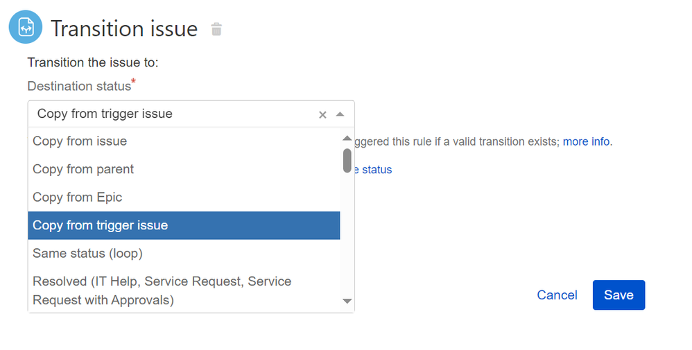

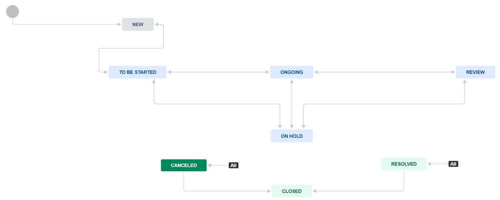

I'm trying to create a rule that can change the Service Request Status based on a set criteria. When the status is Canceled or Resolved, wait 7 days and then transition to Closed, as per the below Workflow.
I can filter out the results using a JQL query and only return the ones I want, below is the example I'm trying to change using the transition action.
It is from here I get stuck trying to change the status to Closed, any advise on is this the correct action to be using, and how to find the status as it isnt showing a field just as Status. Is the "Copy from trigger issue" correct, and where to find the status field to change?

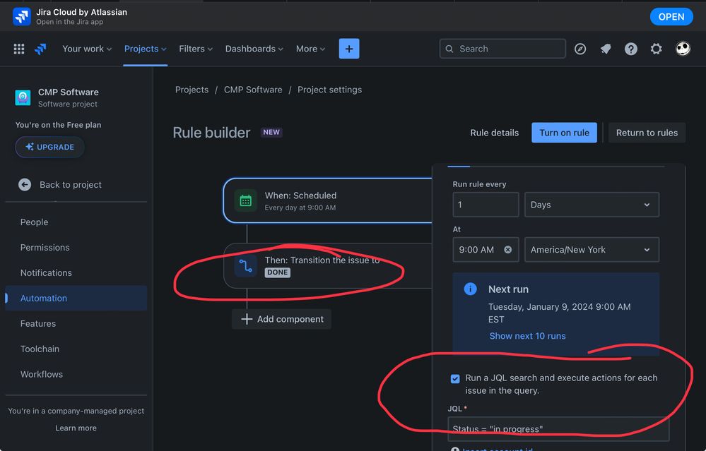

A question for you, why are you declaring the issue (AG-264) in your JQL? I think the solution is much simpler than presented unless I am missing something. Below is an example. I use the Scheduled daily trigger and the key is to tick the box "Run a JQL search and...". Then your JQL, I think, would be - status in (resolved, cancelled) and type = service request and updated < startOfDay(-7)

Can you show us the details of the Scheduled trigger?
What version of Jira are you using? And is it Server or Data Center?
You should not need to have a For branch within this rule. You should be able to select your issues using JQL in the Schedule trigger and then simply follow that with the Transition Issue action. The JQL in the Trigger would look like this:

For the Transition Issue action you would select the option for Selecting a specific transition

My transition issue action doesnt have the option to change from destination status to specific transition.
