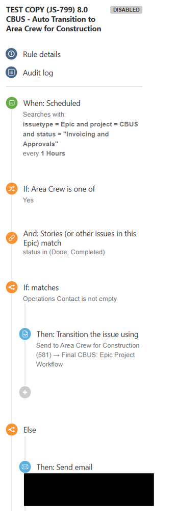

Thanks for your response.  If I understand your suggestion correctly, this is how I can configure the automation rule without using a branch. Correct?
Next question. If Area Crew = No, I need to use a different transition but everything else is the same.  Would you suggest that I create a separate rule to keep things simple or is there a way to work that scenario into this one without complicating things?

March 28, 2025
Yes, that updated rule looks correct.  Well done!

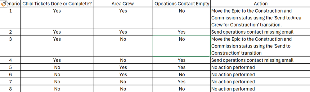

Thanks @Bill Sheboy I like the idea of having one automation rules however I am not sure it will evaluation the If/Else statements as I intended.  I came up with 8 scenarios. The are:

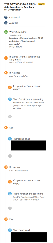

And this is how I configured the automation rule:
Like • Bill Sheboy likes this
March 28, 2025 edited
Well done, and...creating the full logic table helps to use techniques like from Karnaugh Maps to decide what / when to test...
Viewing the table shows only the cases where "Child tickets are Done or Complete" do something, and so moving that test first (before the if / else block) helps.
Next, whenever the Operations Contact is empty, the email is sent.  And so that would be the first test in the if / else block.
Finally, the block may test Area Crew's value last is it impacts the transition-to status.

Thanks! I don't understand what you mean in the last two paragraphs. Are there other changes I need to make to get it to work the way I want it to?
March 28, 2025
As I do not have a Jira Data Center site, I do not know...my suggestions were based on how the if / else block works for Jira Cloud.
I was noting the order of the testing based on most-to-least restrictive, ensuring there would be no overlaps in cases.  If you have tested all of the cases and it works as expected, you are done!
