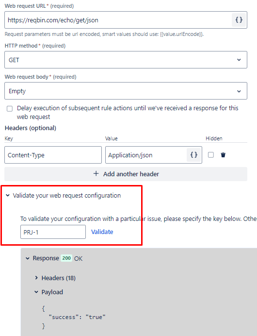

You can check, that you receive responce from webhook, by validating it.
Like in my example. In payload you'll see responce from server. If it's just clean string, then use standard automation action "Edit Issue", select required field there, and fill smart value {{webResponse.body}}
If the body is a JSON object - then you can access values using dot notation. For my example it will be {{webResponse.body.success}}

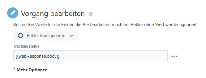

Hi @Evgenii ,
I have tried editing the issue. There I specified the text field as a field and {{webResponse.body}} as the value:
20240922_1756155
These are the webhook settings:
Webhook Validate:

I think, I found the problem.
Enable this checkbox
With it automation must work. I checked on my test site:

Florian N. September 22, 2024
This worked, I activated the checkbox and entered “{{webhookResponse.body}}” for the field when editing the issue. This gives me the response in the field.
Thanks :)
