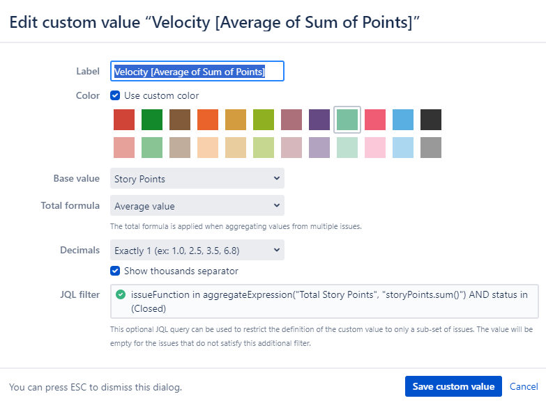

I was trying to use Calculations to do the math to get the team average (yes, Velocity) for each individual member of the team - just to use as a baseline so we do not overburden anyone (all internal).
This is what I came up with - but I cannot figure out how to 'count sprints' instead of using days. This way, it's now always accurate.
Is there a way to 'count sprints'?
issueFunction in expression("filter = 73766", "StoryPoints / 33d")
Filter 73766:
issueFunction in aggregateExpression("Total Story Points", "storyPoints.sum()") AND status in (Closed)
I also tried Custom Values but the numbers are WAY off.  I am using Rich Filters to show only my current Increment.
 what am I doing wrong here?
thanks for your help!

Hi @Isabella Musial,
Counting sprints, most likely, will not be possible. But, if you have sprints of a fixed length, you could divide this by a number representing the number of sprints that fit in the 33 days (if your sprint has 2 weeks, you could divide by 3 instead of 33), thus obtaining a "per sprint" velocity instead of "per day" velocity calculated as the average of past 3 sprints.
Be aware that there might be better alternatives to your current method. For example, you could also try these two gadget offered by our Great Gadgets app. But, again, both will calculate per time interval, not per sprint.
Advanced Issue Filter Formula gadget
Kanban Velocity gadget -  in this case, you will need a gadget for each team member
Hope this helps.
