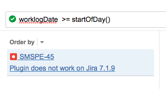

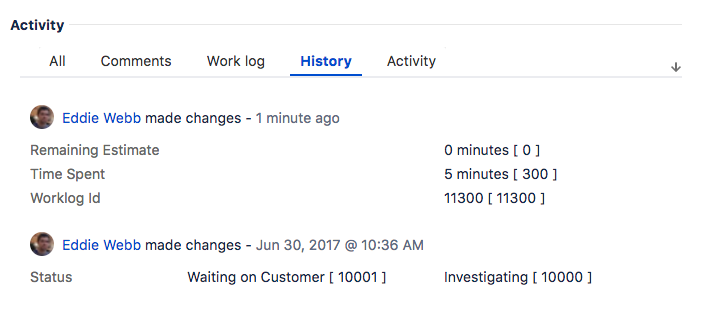

I added work to one ticket .

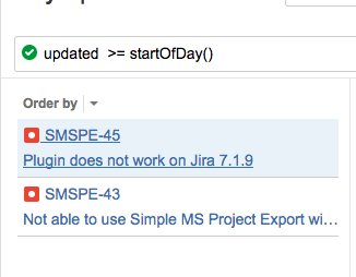

I commented on another ticket, and only using "updated" will show both.
