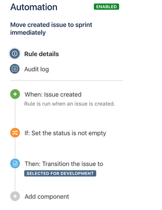

Found a workaround that's could be useful not only for me:
1. Create a checkbox custom field with the name 'Set the status' (or other) with option (e.g status Selected for development) and add it to the issue view.
You will see it on your 'create issue' window.
Actually you could make as many statuses as you want.
2. Create an trigger with condition and action in Jira Automation (it's free):
When: Issue created ->
If: Set the status is not empty (different if you created many statuses)
Then: Transition the status to 'Selected for development'
That's all, now if you select the status while the issue creation it will be automatically change the status.
But anyway hope that Jira developers will focus on that issue soon.
I used the same field, but a different automation rule. The results are the same.
