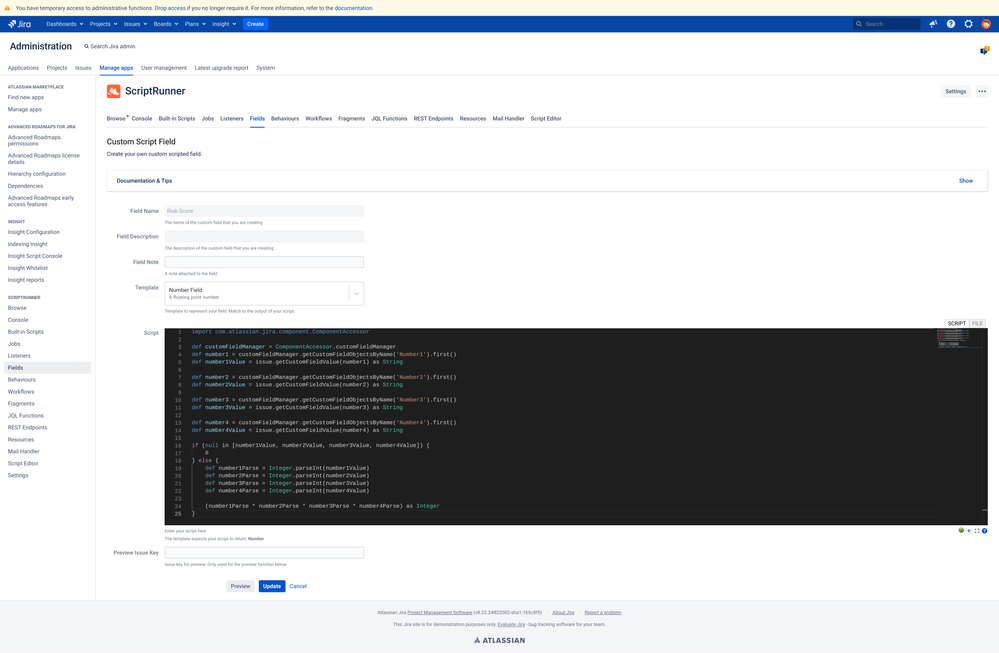

Hi @Joel Batac
If you want your code to work without any exceptions, you should do something like this:-
def customFieldManager = ComponentAccessor.customFieldManager
def number1 = customFieldManager.getCustomFieldObjectsByName('Number1').first()
def number2 = customFieldManager.getCustomFieldObjectsByName('Number2').first()
def number3 = customFieldManager.getCustomFieldObjectsByName('Number3').first()
def number4 = customFieldManager.getCustomFieldObjectsByName('Number4').first()
def number1Value = issue.getCustomFieldValue(number1) as String
def number2Value = issue.getCustomFieldValue(number2) as String
def number3Value = issue.getCustomFieldValue(number3) as String
def number4Value = issue.getCustomFieldValue(number4) as String
if (null in [number1Value, number2Value, number3Value, number4Value]) {
0
} else {
def number1Parse = Integer.parseInt(number1Value)
def number2Parse = Integer.parseInt(number2Value)
def number3Parse = Integer.parseInt(number3Value)
def number4Parse = Integer.parseInt(number4Value)
(number1Parse * number2Parse * number3Parse * number4Parse) as Integer
Please note that this sample code is not 100% exact to your environment. Hence, you will need to make the required modifications.
If you do not use the null check, and if any of the lists are left unselected, i.e. set to None, it will cause a NumberFormatException
Below is a screenshot of the updated configuration:-
