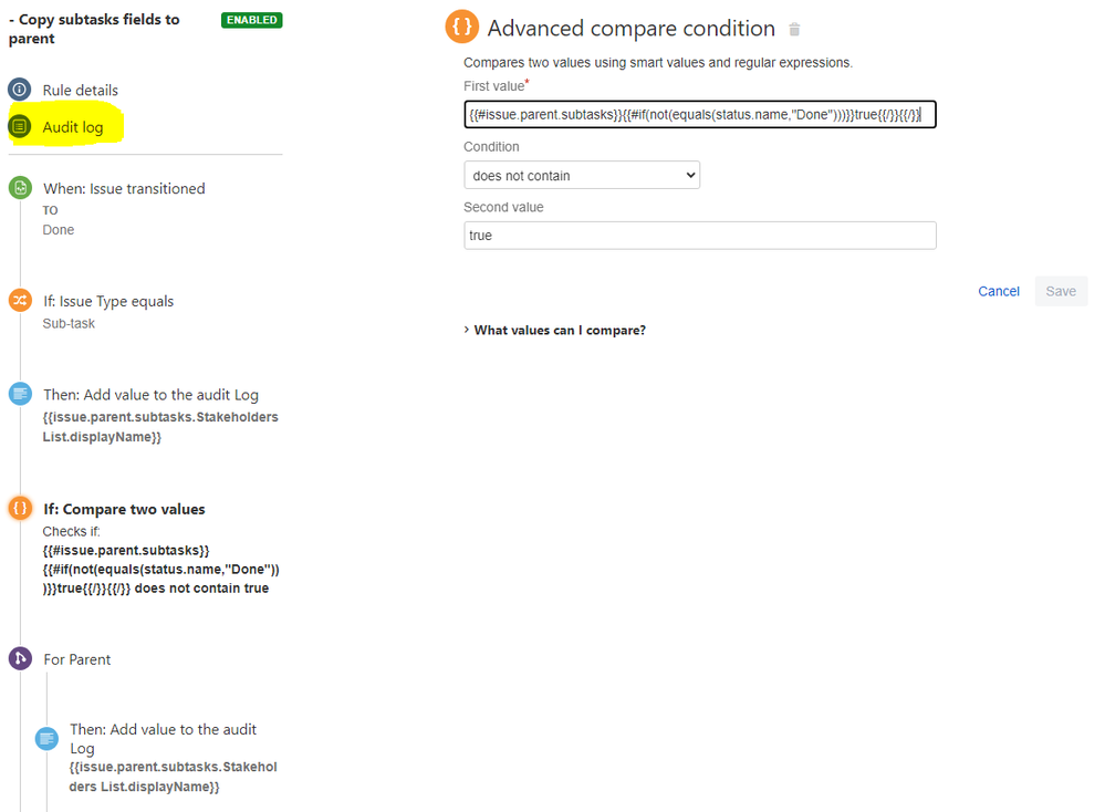

Kalyan Sattaluri
April 5, 2024 edited
@Lusine
I think we can do this without web request step.
  • Create new rule with trigger = issue transitioned, and choose Done as status
  • Next do an if condition and check if Issue Type = sub-task
  • Then, do a log action and log
    • {{issue.parent.subtasks.Stakeholders List.displayName}}
  • Then do another if condition, smart value check, and put:
    • {{#issue.parent.subtasks}}{{#if(not(equals(status.name,"Done")))}}true{{/}}{{/}}
    • DOES NOT CONTAIN
    • true
  • Then do a branch -> For Parent
  • Inside it, log
See below screenshot.
We are not updating the Parent issue yet. We are making sure logic works.
After setting up the rule, trigger it by taking an issue which has 2 subtasks. Transition both 2 done. Share with me the latest Audit log (see yellow highlighted section) along with the rule. I need both screens to understand progress.
If above logic works, we will update the parent. Let me know if any questions.
