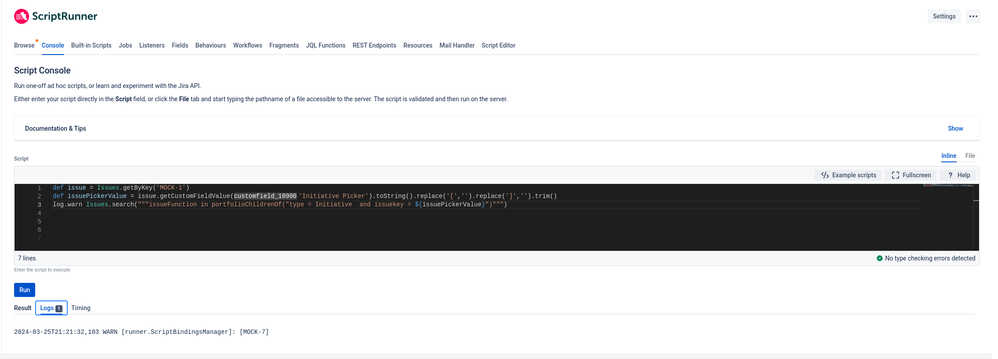

Below is a screenshot for your reference:-
In this example, the Issue Picker value is taken from the issue MOCK-1. The value is the Initiative selected from the Issue Picker.
Once the value from the Issue Picker is extracted, it is placed into the JQL Query.
The result return is the child of the Initiative, i.e. the Epic issue type.
As mentioned above, you will need to modify the code to suite your needs.
