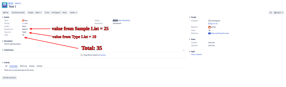

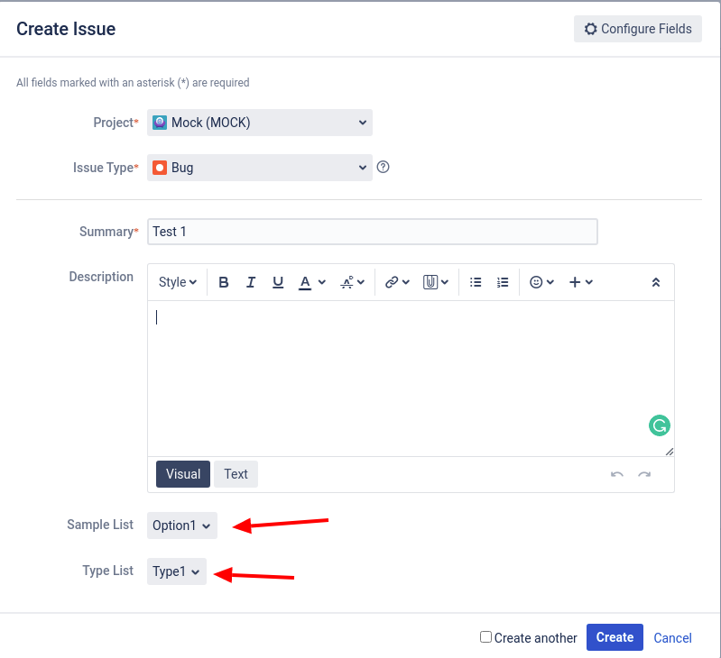

Below are a couple of test screenshots.
1. Firstly, when the issue is created, the Sample List is set to Option1, and the Type List is set to Type1 as shown in the screenshot below:-
2. Once the issue is created, the Total field is displayed with the value of 35, i.e. the value set for Option1 in the sampleListValueMap is 25, and the value for the Type1 in the typeListValueMap is 10. The total of the two values is 35, as expected, as shown in the screenshot below:-
I hope this helps to answer your question. :-)
