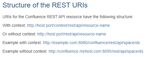

At the top of the documentation it is mentioned:
Tried your suggestion, but then I only get a "page not found".

The confluence rest api documentation has not been updated since 6.6.0
Dario B
November 14, 2019 edited
Hi @zaphnet ,
You are totally right, I have indeed found an old request to fix the documentation that has never been taken into account since it was reported as a suggestion instead of a bug:
I have now changed it to bug and update the description. I will get in touch with DEV soon to ask to have this fixed asap.
