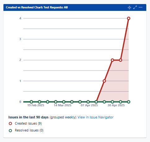

I have created a Created vs Resolved dashboard for a user but the two 'Resolved' tickets are not appearing in the dashboard (provided below). The resolution is set for each resolved ticket but when I filter for these tickets, I notice they don't have a Resolved date in the column of the JQL lookup.
Can someone help me understand what details are missing to allow the dashboard to reflect accurately?

Resolved looks at the moment when a value is set in the resolution field. It does not look at the status -> "resolved" in your screenshot is a status not a resolution.
If these issues are in a company managed project, you should make sure that the resolution field is also set through a workflow post function in the transition to your resolved status (or through a transition screen that allows the user to fill out the field).
If your issues are in a team managed project, you would need to use an automation rule to update the resolution field to obtain the same result.

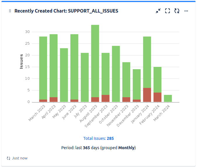

Not sure why is this not working as long as you have the Resolution field set. You could also try the Recently Created Chart gadget of Jira. Or, eventually, open a ticket with Atlassian Support for assistance.
Another option would be to search for a plugin on Atlassian Marketplace that provides such gadget. In case you want to try a plugin, have a look over the gadgets offered by our Great Gadgets app.
