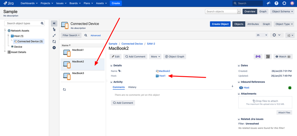

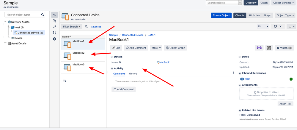

Below are screenshots before the Asset is updated:-

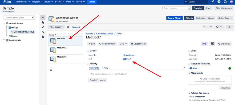

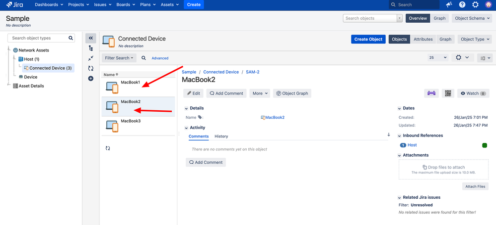

Below are screenshots after the code is triggered:-
If you observe the screenshots above I am able to update the value of the Host field in multiple Assets using the approach I have provided.
