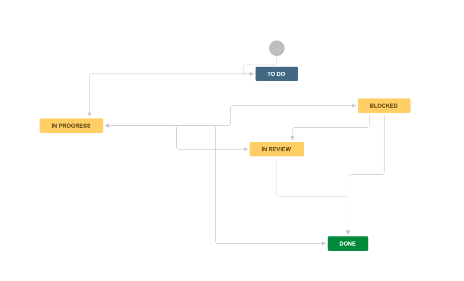

Hey there,
I am really struggling to understand the issue with the custom workflow I recently created, to add a new status to our workflow.
All seems to be set up fine, I have configured all of the transitions, but when I test the workflow the 'done' issues still show up in users issue filters and do not strike through on the boards when moved to 'done'
Is anyone able to help? I included a screenshot of my workflow and below is the regular custom filter our team use to view issues (the one we want the issues to appear as 'done' in)
resolution = Unresolved AND assignee = currentUser() AND sprint in openSprints()
I appreciate I can change the above filter to the below, which solves the issue with the appearance of the issues marked 'done' but it does not strike them out, indicating this may cause wider problems if deployed.
assignee = currentUser() AND sprint in openSprints() AND status not in (done, resolved)
Many thanks in advance,
Mark

Hi @Mark,
Issues are considered Resolved if their resolution field is set with a value. In the native workflows provided, this might be automatically set as a workflow transition post-function. Since you may have created a custom workflow, you will have to consider adding that.
Refer to https://confluence.atlassian.com/jira061/jira-administrator-s-guide/configuring-workflow/advanced-workflow-configuration#Advancedworkflowconfiguration-Postfunctions
You can consider one of the following:
1. Add a post-function to all the statuses that lead to the Done status and set the Resolution field to Done
2. Display a screen with the resolution field for all transitions that lead to the Done status and allow your users to select the Resolution accordingly
Hope that helps.

Mikael Sandberg
July 16, 2018
In order to see the strike through you need to set a resolution on the issue.
Mark
July 16, 2018
Thanks! I think this is what I am missing. How do I assign 'done' as the resolution?
I have looked all over but I cannot find an option for this within the workflow, nor see where it is set in other default workflows.
