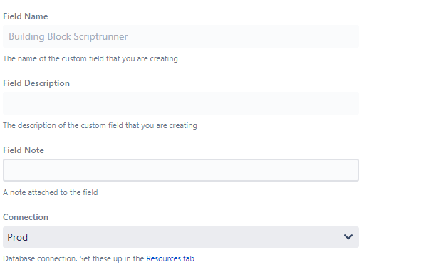

Hello @Ram Kumar Aravindakshan _Adaptavist_ ,
Good day. I see three entries for all the three projects For example: For CNA project we have only one value but I get the same option thrice and all three are selectable. From table perspective we don't have any duplicate entries.
Please see the screenshot for my entire configuration.

Hi @Ram Kumar Aravindakshan _Adaptavist_ ,
Adding more screenshot for your understanding.
Best regards,
Jeyanth
This clearly indicates that the columns you are invoking are used in multiple rows, hence the duplicates.
Please modify your SQL Query and add the DISTINCT keyword, as shown below and see if the duplicate values are removed.
Many thanks again for your reply. I was able to successfully fix the problem with our earlier script. The reason why there are 3 entries in the drop down value is due to 3 custom fields with same values in Jira. I have added additionally the customfield id. Please find it below
