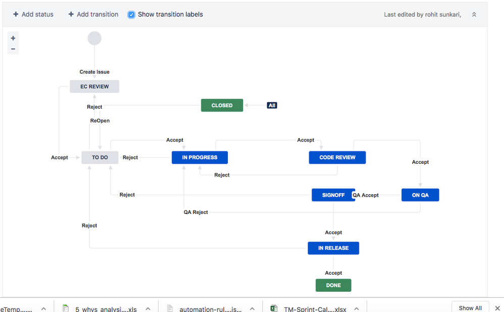

Hey Guys,
I've had difficulty setting the validation for if field value is modified during a transition. What've done so far is, added a validator from QA to Sign Off wherein if time spent is where I've added my validation i.e from transitioning to QA  to Sign Off time spent should be entered/updated. I get the alert if the time spent is not updated. However, I'm still getting the alert even if the time spent is entered in this transition. I tried adding screens too but that also didn't work.
Any possible solutions for me?

May 17, 2019
Hi Anand,
I wanted you to know that I moved this reply into its own question.  It just felt like it was different enough that it shouldn't be answered in the thread of the other post.
I understand that you are having a problem with a validator in your workflow.  However I'm unclear of the details here.  What field is using the QA and Sign Off values?  Could you post us a screenshot of your validator settings?  I might help us to better understand your specific environment and this situation to be able to offer more help here.
Andy
Anand Vardhan
May 19, 2019
Hey Andrew,
Thanks for the update!
I'm attaching two screenshots. One for the workflow and other for the validator. I've added the validator when the issue is being moved from QA to  Sign OffScreen Shot 2019-05-20 at 11.09.39 AM.png Screen Shot 2019-05-20 at 11.10.18 AM.png
