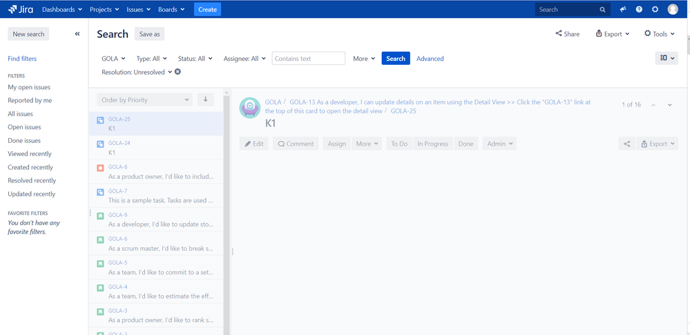

The problem shows up when I tried to vist the search page, something like:
http://localhost:2990/jira/browse/GOLA-25?jql=project%20%...
Now the code snipped above doesn't work anymore, on the "document ready" event, I get NullPointerException in the first line that access to "mother-panel".
It means that the div is not there when the document ready event fired, but some how it would be rendered later as I can see it in the UI as well.
I guest that the issue detail component, which contains the "mother-panel" was lazy load later by AJAX.
My question is: Is there some way that I can access to "mother-panel" right after the moment it been rendered? Thank you.
