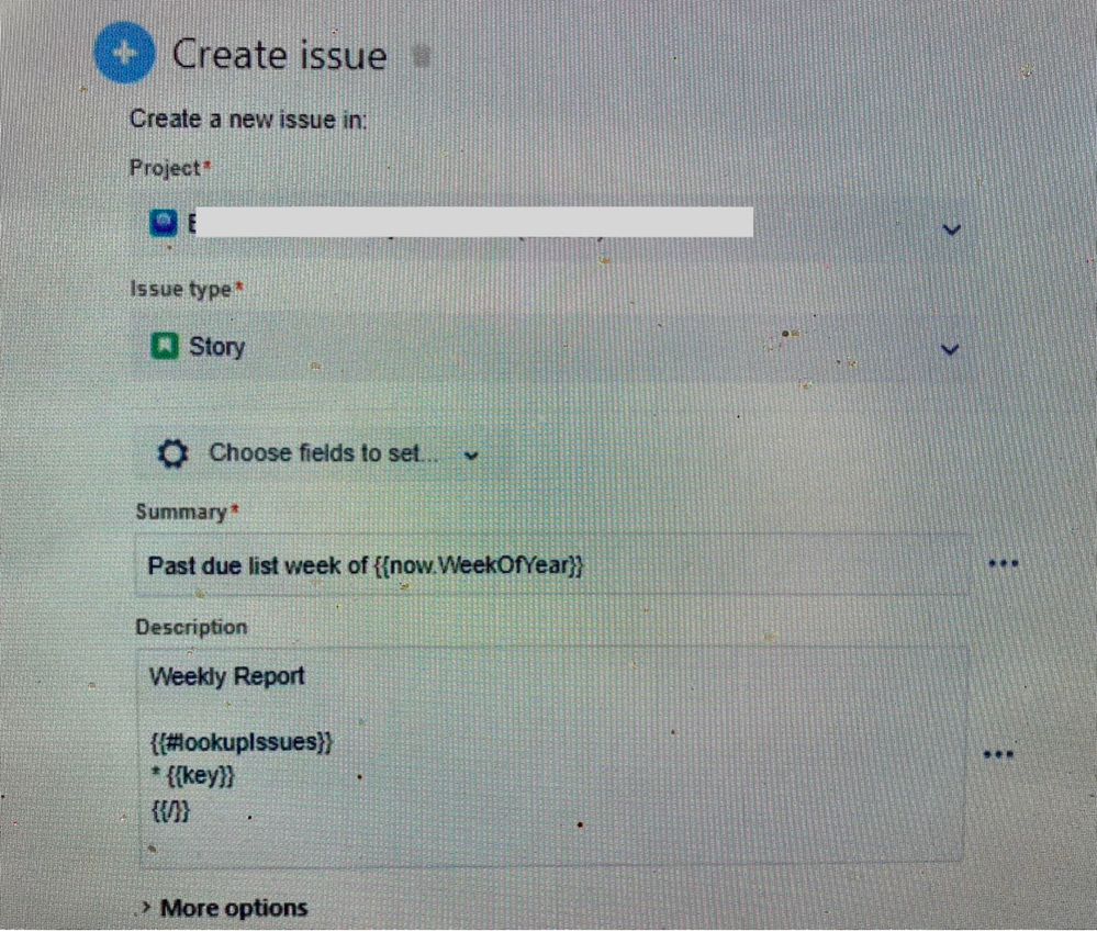

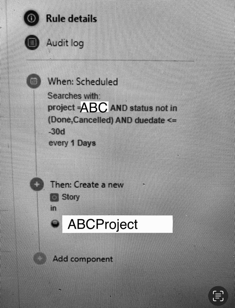

Absolutely stumped trying to create a filtered list in 1 Card for a Kanban
Every Monday
Create 1 card of all the late cards for the week
Link all the late card to this 1 card
The logic in place create a card for each late card. I can use this logic if I’m emailing  multiple late notifications, but the manager just wants 1 card a week.
I have tried in a branch & without a branch
Most recently created issue, current issue
So far the schedule & filter works.
When: Scheduled Every Mon
filter: Project = ABC AND Status not in (Done, Cancelled) AND duedate <-1
then Create a new
Story
Edit Description
{{#lookupIssues}}
* {{key}} {{issue.summary}}
{{/}}FDAE573E-5951-4FD2-8A64-A0ECA65137DE.jpeg 97FA50AB-B9ED-48F1-A146-7C9BF3751061.jpeg

Assuming you have the conversation above and still want to do this, try adjusting your rule as follows:
  • trigger: scheduled with no JQL
  • action: lookup issues with the JQL you were using
  • advanced compare condition:
    • first value: {{lookupIssues.size|0}}
    • condition: greater than
    • second value: 0
  • action: create your issue
