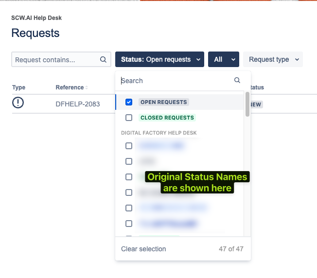

Atacan Emre January 31, 2024
This solution helps to reduce the notification, but still customers see original statuses instead of customer-visible statuses while filtering on customer portal. Any solution to that?
