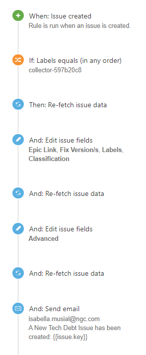

Isabella Musial
August 30, 2023
August 30, 2023
You are missing 2 calls to Re-fetch Issue...
Add one immediately after the trigger, and before the condition test
Add another after the first edit issue action.
So the rule will look like this:
  • trigger...
  • action: Re-fetch issue
  • condition...
  • action: edit issue for Epic Link, Fix Versions, Labels, and Classification
  • action: advanced edit for the Team field
  • action send email
Like • Isabella Musial likes this
Isabella Musial
August 30, 2023
Isabella Musial
August 30, 2023
So like this? ^^
but what about the Team field? Its crazy that it's not there when it's out of the box on Advanced Plan - is that because it's a 3rd party or a plugin?
Isabella Musial
August 30, 2023
FYI - Re-Fetch worked and all fields populated.
