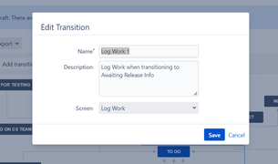

Hi @Yasin HALICI
Are you using cloud or server? Here are the steps I took but when I move a ticket status from "In Progress" to "Awaiting Release Info" the system changes the status but I do not get the "Work Log" pop up screen I created. I am sure I am missing something, like perhaps I haven't associated the screen properly? Any insight you or @Dirk Ronsmans might have would be appreciated. :) (Yes we have a pretty complex workflow - we used a Jira Contractor to customize our workflow).
  1. I first went to Workflows and selected the workflow we use for our project and clicked edit.
  2. I then clicked on the connector between "In Progress" and "Awaiting Release Info" and then I clicked on "Add Transition"
  4. This is what my Transition box looks like:2022-05-12_10h24_06.png
  5. Then I published my change.
  6. I then went to an open ticket and put the ticket "In Progress"
  7. I then moved the status to "Awaiting Release Info"
  8. The system changed the status but no pop-up screen appeared.
  9. I have associated my "Log Work" screen with the workflow that I use but I have to be missing something.... ?2022-05-12_10h28_25.png
Thanks for the help!
Sara

Dirk Ronsmans
May 16, 2022 edited
Going by the screenshots it seems good.
I do see there is also an "All" arrow going in to awaiting release info so you basically have 2 transitions going there.
Are you sure you performed the right one? Might be easiest if you give them both a clear name to be sure.
Going by the screenshot you might need to do the "Log Work 1" transition.
