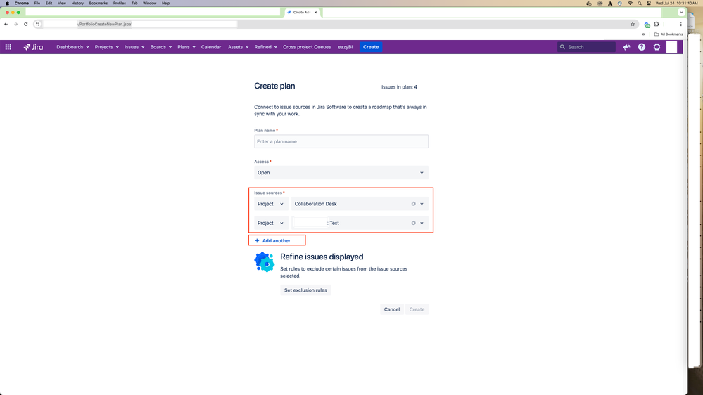

The organization I am working for is using Jira Data Center (it has Advanced Roadmap feature) and currently we have created a Roadmap under Plan. However, it currently tracks 1 project.
For example, in the below screenshot, we can import multiple projects under Issue Sources

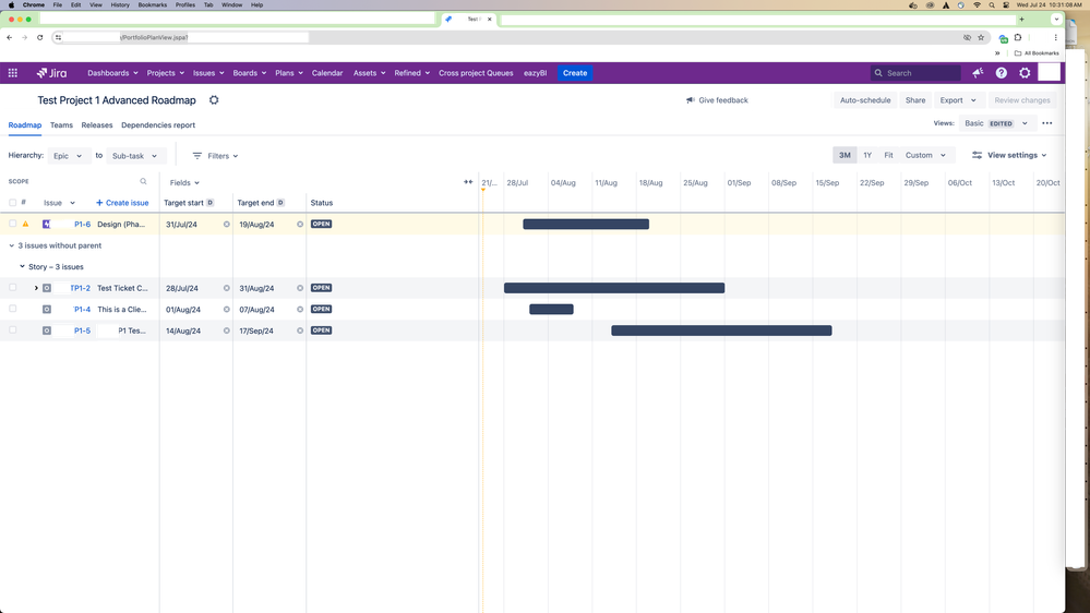

In the below screenshot, it is a Roadmap with only 1 project. Now how do I import more projects to the Roadmap called "Test Project 1 Advanced Roadmap" after this roadmap is created? Where is the place that I can import multiple projects to the roadmap?

Hello @Kevin Lu
Click on the gear icon next to the Roadmap name and select Configure.
That will open a page where you can get to the configuration options for the Plan including the configuration of the data sources.
