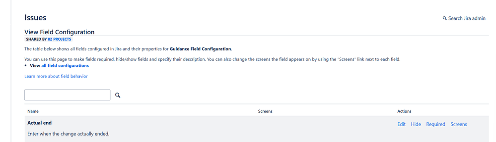

Under a particular project, I've clicked Project Settings, then selected Fields, then Actions > Edit Fields, clicked on the field configuration and for "Impact" assigned it to a screen:

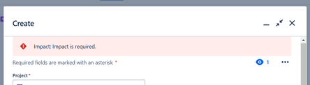

However, the problem is that when other issues are created, JIRA is now saying that "Impact" is mandatory, but "Impact" doesn't appear anywhere on the form???!!!:
and thus I have to go back to the Issues View Field Configuration screen and mark the field as Optional (and not Required).

You have made the field mandatory by navigating to the field configuration, which is one of the correct ways to make the field mandatory, but is not applicable for your use case. Because your field configuration is shared with 82 projects, this change will apply to all those projects.
Since you want to make the Impact field mandatory when the issue moves to the Awaiting Test status, the correct method would be to use the workflow validators. This way, you can limit your change to the desired project and issue type, and enforce it at the required status transition only.
The workflow configuration steps from the below article should help:
Making a field mandatory
You can test this approach on a test project and workflow, then implement the changes in your project. Also, you can revert the changes made to the field configuration.

From the configuration perspective, the field, even if not added to the screen, must be filled if it's globally marked as required and assigned to the specific field configuration.
