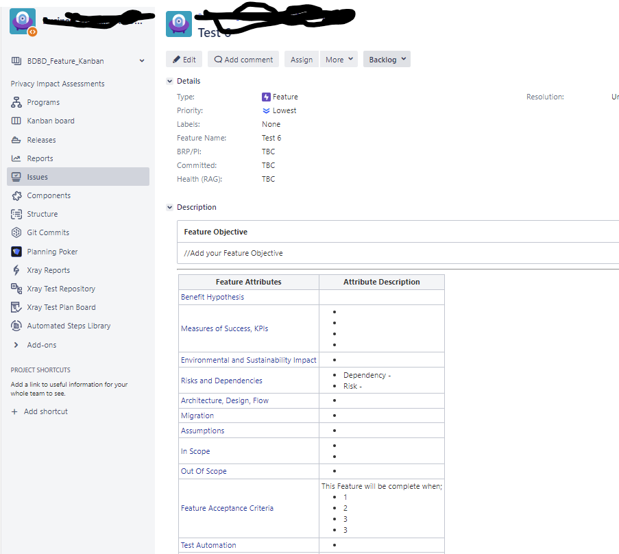

Hi everyone!
I try to find out if there are a way to insert a template in the issue description that shows up for everyone when someone wishes to create a new user story. It could be a template where te designteam shoud do something, next part the test team and last one the developer team.
Any ideas?

Use the Automation and below script to create the template whenever a issue gets created.
{{triggerissue.Description}}
{panel:title=Feature Objective}
//Add your Feature Objective
{panel}
||Feature Attributes||Attribute Description||
|{color:#0747a6}Benefit Hypothesis{color}| |
|{color:#0747a6}Measures of Success, KPIs{color}| * {color:#172b4d} {color}
|{color:#0747a6}Environmental and Sustainability Impact{color}| * |
|{color:#0747a6}Risks and Dependencies{color}| * Dependency -
* Risk - |
|{color:#0747a6}Architecture, Design, Flow{color}| * |
|{color:#0747a6}Migration{color}| * |
|{color:#0747a6}Assumptions{color}| * |
|{color:#0747a6}In Scope{color}| *
|{color:#0747a6}Out Of Scope{color}| * |
|{color:#0747a6}Feature Acceptance Criteria{color}|This Feature will be complete when;
* 1
* 2
* 3
* 3 |
|{color:#0747a6}Test Automation{color}| * |
|{color:#0747a6}Release Plan{color}| *
Yatiraj Sharma
November 27, 2024
You will see something like this
