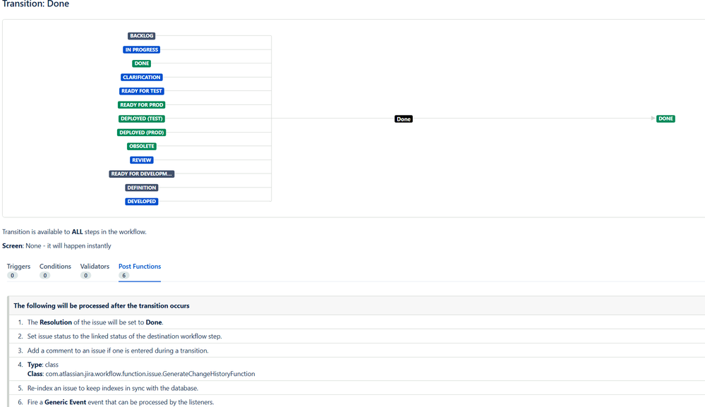

1. So basically I will remove the "Resolution" field from the screens.
2. I created a Screen named "Set Resolution Screen" but I did not add it to a scheme.
3. So now how do I find the option in my workflow to add the "Set Resolution Screen", so that people are getting a popup.
4. Do I really need a post function that clears the "Resolution" field, altough I dont have a reopen transition?
Here is my config:
