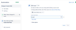

Using Jira Automation you might be able to achieve this :
Above is a small one I tried at my end. It triggers when any Label is changed, and adds the current Date and time to the Custom field using the {{now}} smart value.
