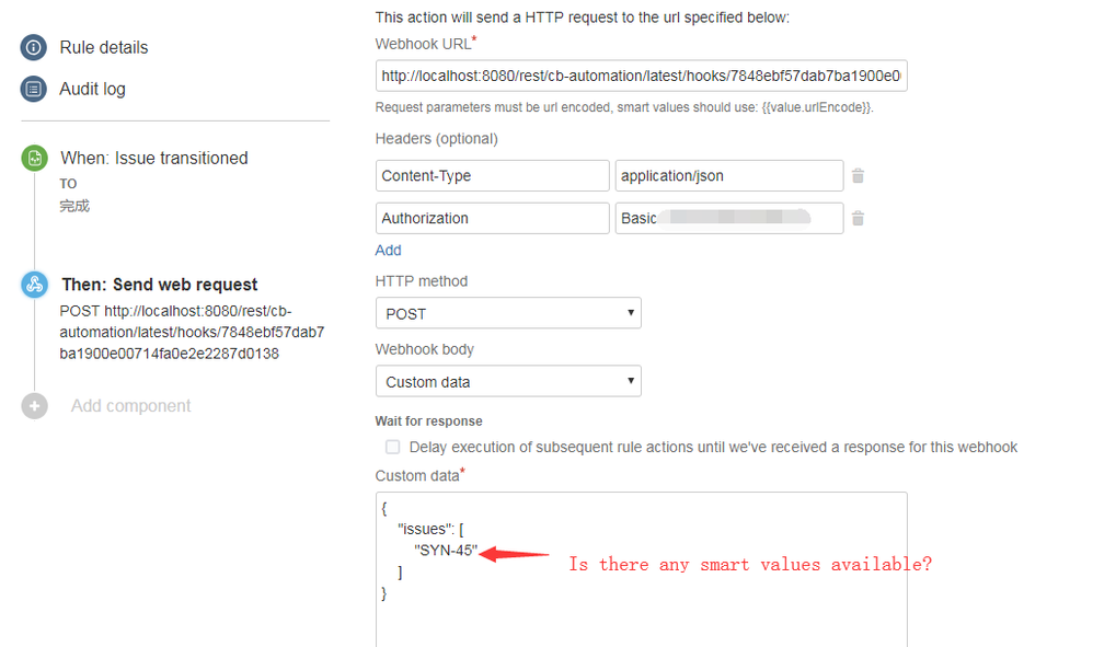

I am going to use project automation to implement my cross-project workflow.
When the A issue is 'done', the linked issue——B issue will also be transited to 'done'. (B issue is the only issue linked with A issue)
Is there any smart values to get the issue id linked with the A issue?
Thanks in advance.

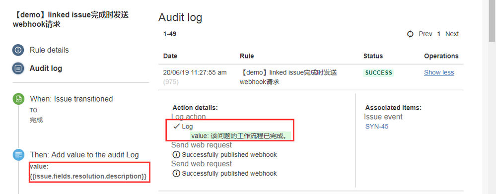

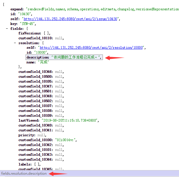

I got the smart value of the field I needed according to this tutorial, but when I configured this smart value in my project automation rule, I could not get the value corresponding to the smart value.
Excuse me, which step did I do wrong?
The smart value of the field I needed:
My configuration in project automation rule was as follows :
As shown above, I could not get the value corresponding to the smart value.
I also tried {{issue.issuelinks[0].outwardIssue.key}} and {{issuelinks[0].outwardIssue.key}}, , but they didn’t work.
And I have tried some other smart values , like {{issue.key}}、{{issue.fields.resolution.description}} , they work fine.
Could you help me?
Sebastian Krzewiński
June 24, 2019
hi @饶青
As I understand what you want to achieve is that you want list all issue keys of linked issues.
You must remember that you have 2 types of links: inward and outward.
Also you must remember that JIRA build an array of linked issues in specific type. So if you have 3 linked issues (2 outward type, 1 inward type) you will be have arrays with 3 elements.
You ask for first element in array. IMHO you should ask for all array because you never know how many linked issues you have.
What I found:
  • to list all linked issues (inward and outward) - {{issue.issuelinks.issue.key}}
  • to list outward links only - {{issue.issuelinks.outwardIssue.key}}
  • to list inward links onty - {{issue.issuelinks.inwardIssue.key}}
I hope that will help you :)
Seba
