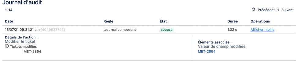

Dave Bosman [Realdolmen]
July 16, 2021
Could you share a screenshot of the audit?
Also, the user that is executing the rule, does he have permissions in that project?
Rémy PREVOT July 16, 2021
@Dave Bosman [Realdolmen] ,
The user is the admin and we gave it all the necessary permissions on the project.
Here is the screenshot :
Here is a screenshot of the modification :
Screenshot of the result :
Screenshot of the existing component list :
Rémy
