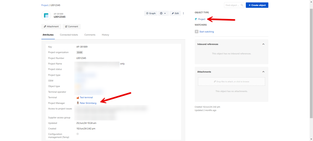

Peter Strömberg August 12, 2024
Thanks Lisa,
Perhaps getting closer, but still generating error.
I enclose some pictures showing the object, attribute, and search result.

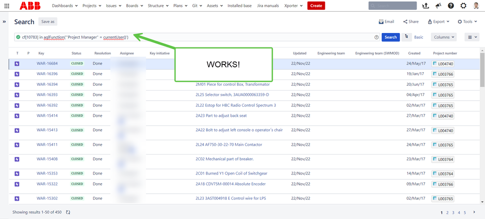

Peter Strömberg August 13, 2024
Thanks a lot Lisa!
It finally worked!! :)
I used this search string: cf[10783] in aqlFunction('"Project Manager" = currentUser()')
See screenshot.
This opens for a lot of new possibilities in building Structures, dashboards and searching issues. Issue resolved.
