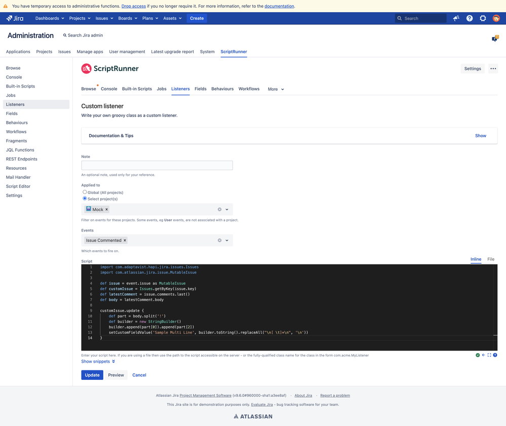

Below is a screenshot of the Listener configuration:-
In the sample code that I have provided, the Comment is split into a list which contains 3 items, i.e. the first line of the comment, the attachment and the second line of the comment.
Since only the text is required, only the first line and second line of the comment are extracted and added to the Multi-Line text field.
Please note the code will need to be modified according to the scenario. If you have multiple attachments added to the comment, you will need to filter it out accordingly.
I hope this helps to answer your question. :-)

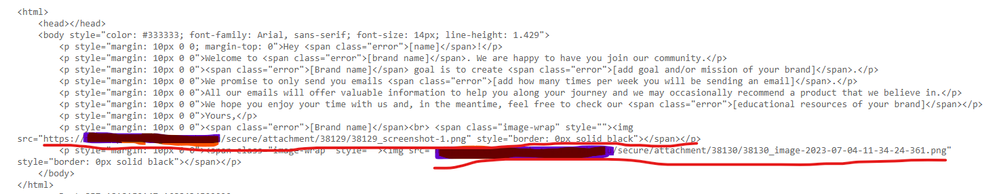

Thanks for the detailed instructions. Ideally, I want to remove <img src> tags from the script runner post function email. My current configuration looks like this. Unfortunately, the output of the last comment includes attachment links from all inline images.
Do you know if there's a way to modify the email template so it could only display the email text in HTML format? Please see attached screenshot. My current configuration is as follows,
