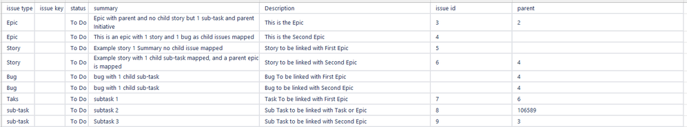

I have a requirement ,some example given below
I have to create a new epic ,Bug Tasks and Sub Tasks newly and link them each other properly
I would need a working template ,in the above what is the change i would need to do in csv file and the setting to be done in JIRA to do this import properly .Aim is to create everything one by one and link them properly .

Marx May 22, 2025 edited
As this JIRA is in project managed and not in cloud , your given tags and my system fields not matching , tried your update ,not working ,
Few errors : Task not associated with Subtask
Epic name is required
only Task created no EPIC created , No linking done
the modified format of the CSV is here

Marx May 22, 2025
summaryEpic Nameissue type/
Work Type
issue id/
work item id
parentassigneeDevelopment Team
Epic with parent and no child story but 1 sub-task and parent Initiative Epic1 RKumar36Other
TaskEpic with parent and no child storyTask21RKumar36Other

Marx May 26, 2025
This format is not working ; Very simple EPIC to Task Linking is required after it is newly created ; Please share the template i will try the same.
