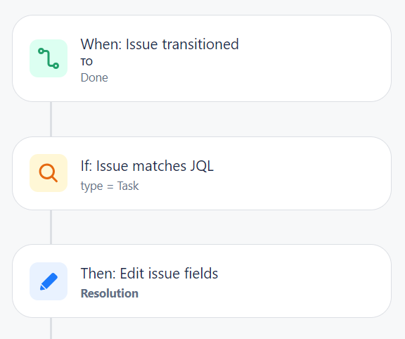

I tried the
when issue transitions done
if issue matches JQL
type = Task
The edit issue field resolution
Done
This didn't work. I also tried issue type is subtask and story but none of them worked.
