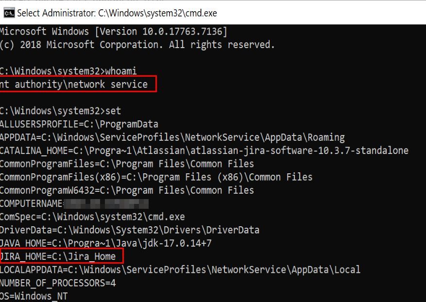

So long as the environment variable is set at the system level (not user level) then any new instance of cmd.exe should inherit that variable. As a test, I've set the %JIRA_HOME% variable at the system level using my administrator account. Then using PsExec I launched a new cmd.exe session as NT AUTHORITY\NETWORK SERVICE.
PsExec.exe -i -u "NT Authority\Network Service" cmd.exe
As you can see in the screenshot below the %JIRA_HOME% variable is available.

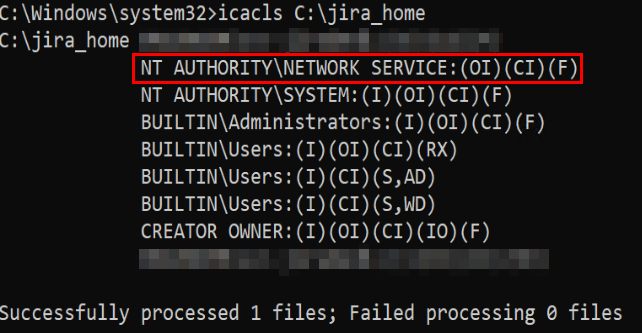

I've also confirmed that the NT AUTHORITY\NETWORK SERVICE security principal has full access to the Jira home directory to eliminate ACLs being an issue.
