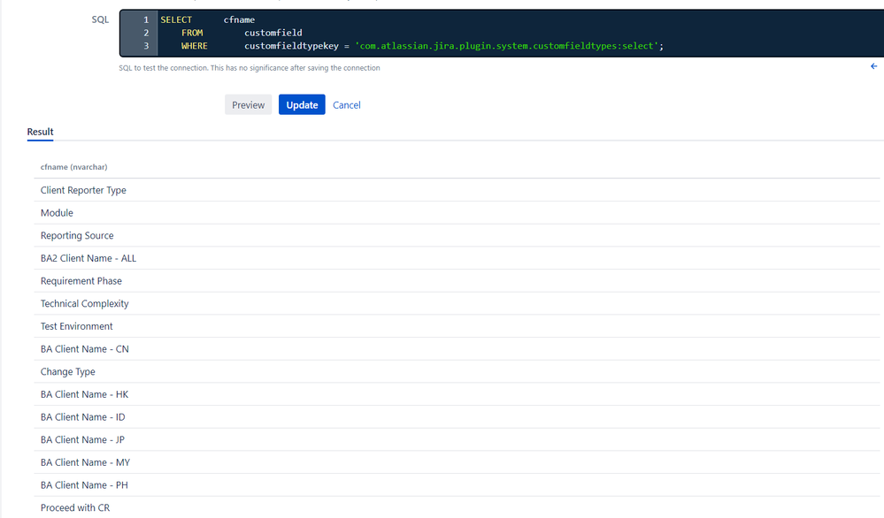

Below Screenshot when running query on Local Database connection.

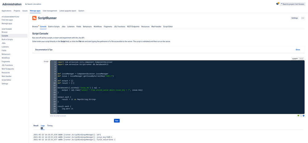

Instead of using the ConnectionFactory etc., to establish the connection to the Database to execute your query, please try and use ScriptRunner's DatabaseUtil, i.e. com.onresolve.scriptrunner.db.DatabaseUtil.
Below is a sample working code for your reference:-
import com.onresolve.scriptrunner.db.DatabaseUtil
def issueManager = ComponentAccessor.issueManager
def issue = issueManager.getIssueByCurrentKey("SAM-1")
def output = []
def result = [:]
DatabaseUtil.withSql('local_db') { sql ->
output = sql.rows("select * from stored_value where issue_key = ?", issue.key)
output.each {
result = it as Map<String,String>
result.each {
log.warn it
Please note, this sample code is not 100% exact to your environment. Hence, you will need to modify it accordingly.

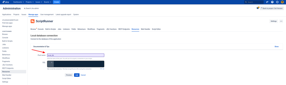

The local_db used in the code above refers to the Local Database connection shown below:-
Below is a print screen of the output:-
I hope this helps to answer your question. :)

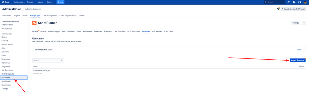

To answer your question, yes, you will first need to set up a connection to your Local Database, i.e. the database your Jira instance is connected to using ScriptRunner's Resources.
Looking at the configuration print screen that you have shared in your previous comment, it appears that you have already configured it. And, have you saved the Local Database configuration?

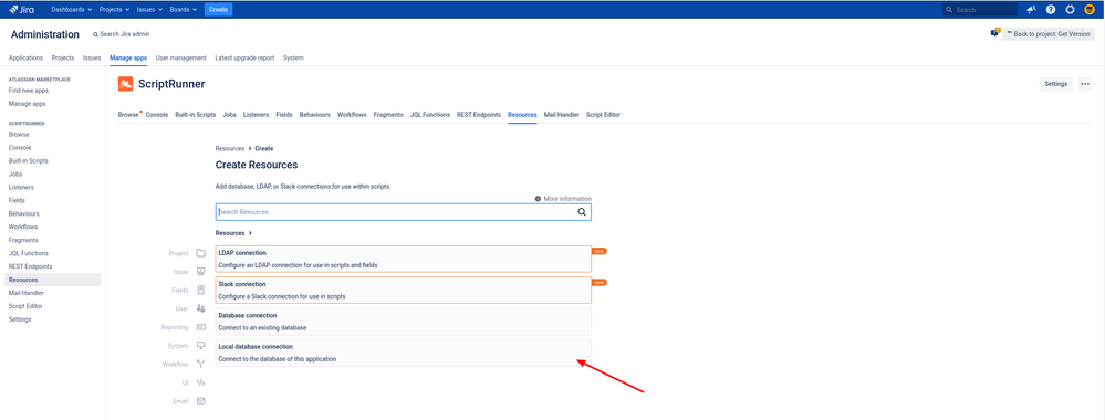

First, go to ScriptRunner's Resources and setup and Local Database connection as shown below:-
Once you have selected Create Resources, select Local Database connection as shown below:-
Next, enter the name you want to use for the Local Database connection and save it.
In the print screen above, the Local Database name set is local_db. This is the same name that is used in the DatabaseUtil.withSql shown in the sample code below.

@Ram Kumar Aravindakshan _Adaptavist_ Intially i was trying without creating connection with the local database. I was simply trying to run script in script console.
Now i have created local database connection having name local_db and SQL box is empty. Now i am trying to run below query :-
it's giving me only single value, i need complete list of fields. I have tried to change sql.rows to sql.eachRow but not working. Kindly suggest.
