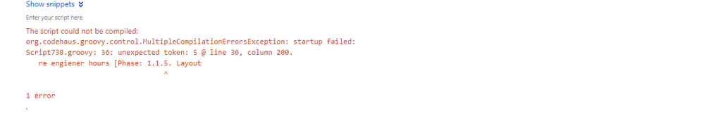

I have the following code (in ScriptRunner):
TestGeos111(httpMethod: "POST"){ MultivaluedMap queryParams, String body ->
def curl = "curl \
-u <uname>:<password> \
-X POST\
--data '{"validator": "name","comments": [{"body": "Project has been validated."}],"items": [{"type": "hours","reference": "3HSWDEVELOPMENT","description": "Software engiener hours [Phase: 1.1.5. Layout void any misswork]","quantity": 66,"unitPrice": 500.00},{"type": "hours","reference": "3HSUPPORT","description": "Support Engineer hours [Phase: 8. Validation]","quantity":55,"unitPrice": 200.00}]}' \
-H Content-Type:application/json \
https://ebes.example.com/API/Engineering/Analysis/Validate?Plant=EAES&PartNumber=R170025Y001001"
def output = curl.execute().text
but i get below error . Is my way to pass json body is incorrect ? please help me with this .

Hello @sgole ,
I might not be the best person to answer this question since I don't use scriptrunner myself but, reading the returned error message, it looks like the part of text inside the square brackets is not treated as normal text:
Now, even if the below body looks correct, can you kindly try the following:
  1. Confirm everything works fine by running the same command from the terminal (if it fails, please paste the output in here):
    curl \
    -X POST\
  2. If everything looks correctly from the terminal, then just try to remove the parts among square brackets in your code, execute it again and see if this is now working or if any other error is returned:
    def curl = "curl \
    -X POST\
    --data '{"validator": "name","comments": [{"body": "Project has been validated."}],"items": [{"type": "hours","reference": "3HSWDEVELOPMENT","description": "Software engineer hours","quantity": 66,"unitPrice": 500.00},{"type": "hours","reference": "3HSUPPORT","description": "Support Engineer hours","quantity":55,"unitPrice": 200.00}]}' \
I hope this helps.
