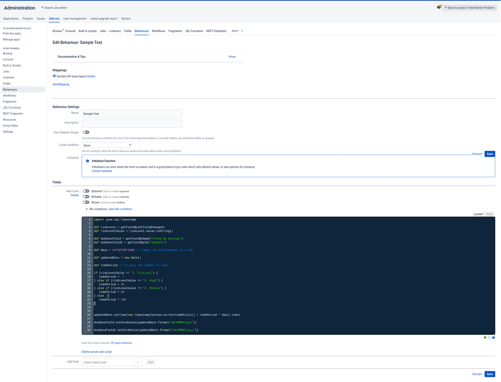

For the Behaviour configuration, since your value is depending on the change of the Risk Level field, it would be better to use a Server Side Behaviour configuration.
Below is a print screen of the same Server Side Behaviour configuration:-
Below is a sample code for your reference:-
