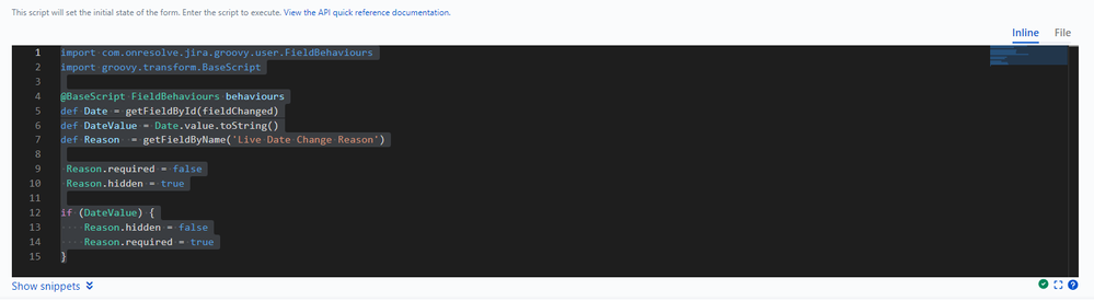

Hello @Ram Kumar Aravindakshan _Adaptavist_
I am trying to introduce similar automation to make sure the Due date Change Reason (multiline text) is mandatory when the Due Date field (date type) changes its value.
When the field changes from BLANK to Value no need to populate the field.
am not a hardcore developer, took the reference of your code. log says no failure in executions.this is at the issue creation stage
