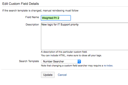

I am not sure if you ever figured this out, but I just ran into this exact issue. I was having trouble getting my scripted fields to search by their numeric value. All you need to do is:
This should allow JIRA to sort the numbers based on their numeric values. It worked for me. See attached image.
Thank you! I must have overlooked the Searcher Option.
By first looks, I think this solved my Issue!!
