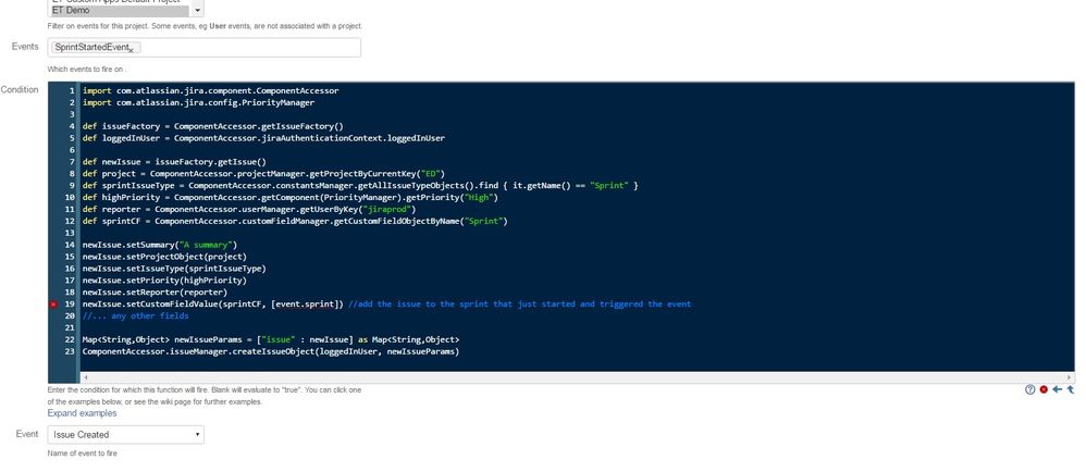

So your custom script listener will look like

Hey Manikandan,
The listener should be a Custom Listener

Manikandan K November 9, 2017
Thanks @Thanos Batagiannis [Adaptavist]. It worked.
