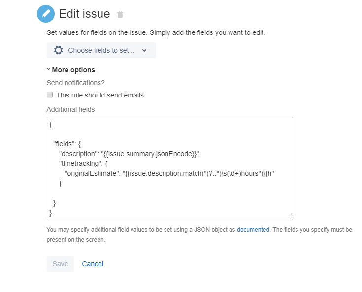

revyx October 1, 2019
Hello, thanks for your answer Fran. unfortunately I get an error when trying to run it.
Description in the field:
In the automation rules it looks like:
image.png Error:
fran garcia gomera
October 1, 2019
The regex is prepared for finding the text after some other text, change it by deleting (?:.*)\s and It will find the 'xxxhours' at beginning of the line, if you add \s* it will find 'xxx hours' with or without space between the number and the word hours.
playing with the regex you can make this work fine.
I recomend you https://regexr.com to try and to learn about regex
Like • revyx likes this
revyx October 2, 2019
Thanks Fran! I was able to make it work in all cases, thanks for the help and the recommendation on regex, will definitely have a look to learn more.
