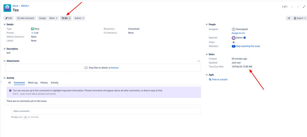

Below is a screenshot of the Post-Function configuration:-
If you observe the screenshot above, the ScriptRunner editor is complaining about a TypeScript check. You can ignore it, as the code works just fine.
Below are a couple of test screenshots for your reference:-
1. When the issue is first created, the date is set to 15 February 2024 00:00:00, but the format displayed in this instance is 15/Feb/24 12:00 AM.
2. Once the issue transitions to In Progress, as expected, the date time field is updated to 15 February 2024 17:00. The format displayed is 15/Feb/24 5:00 PM.
